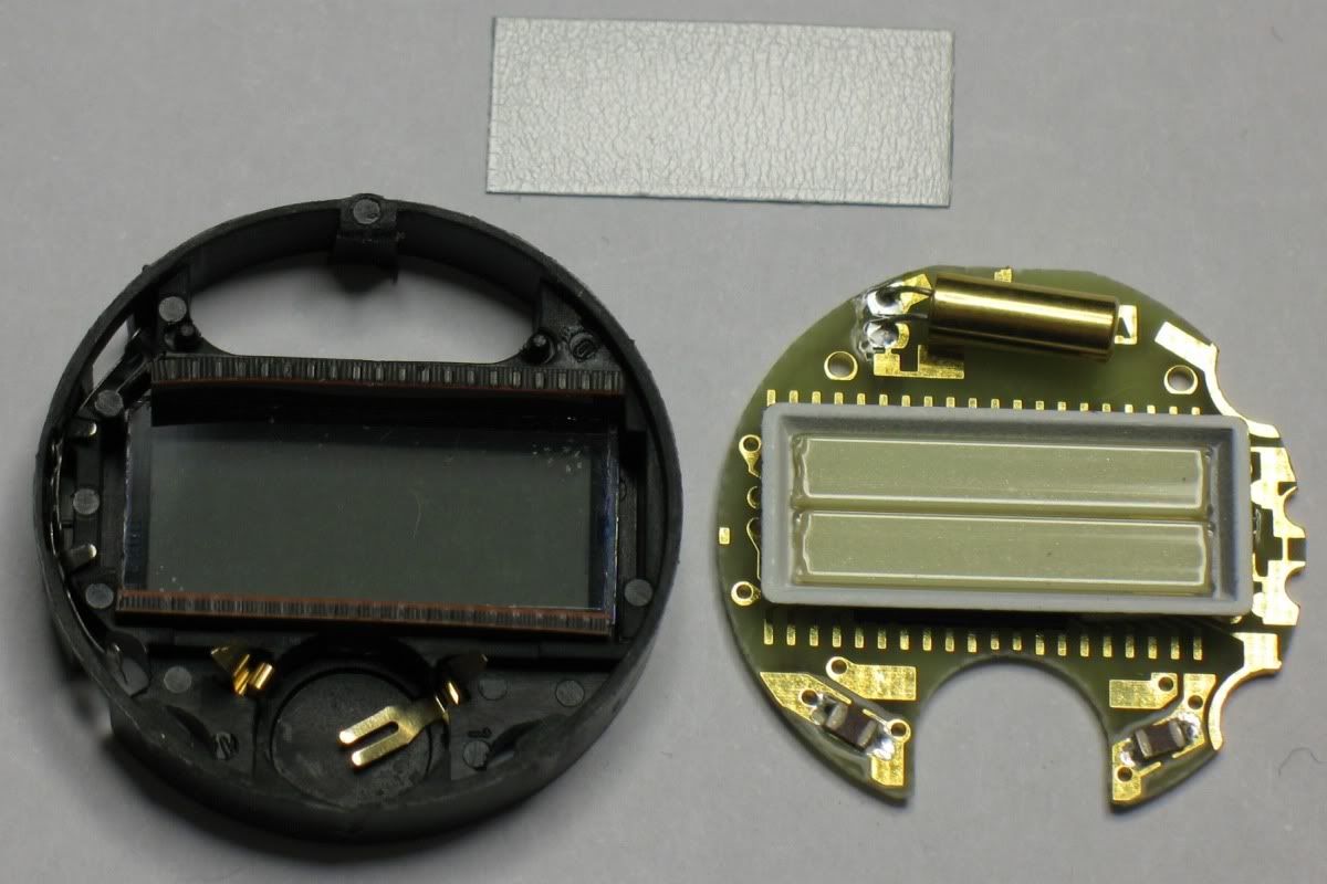

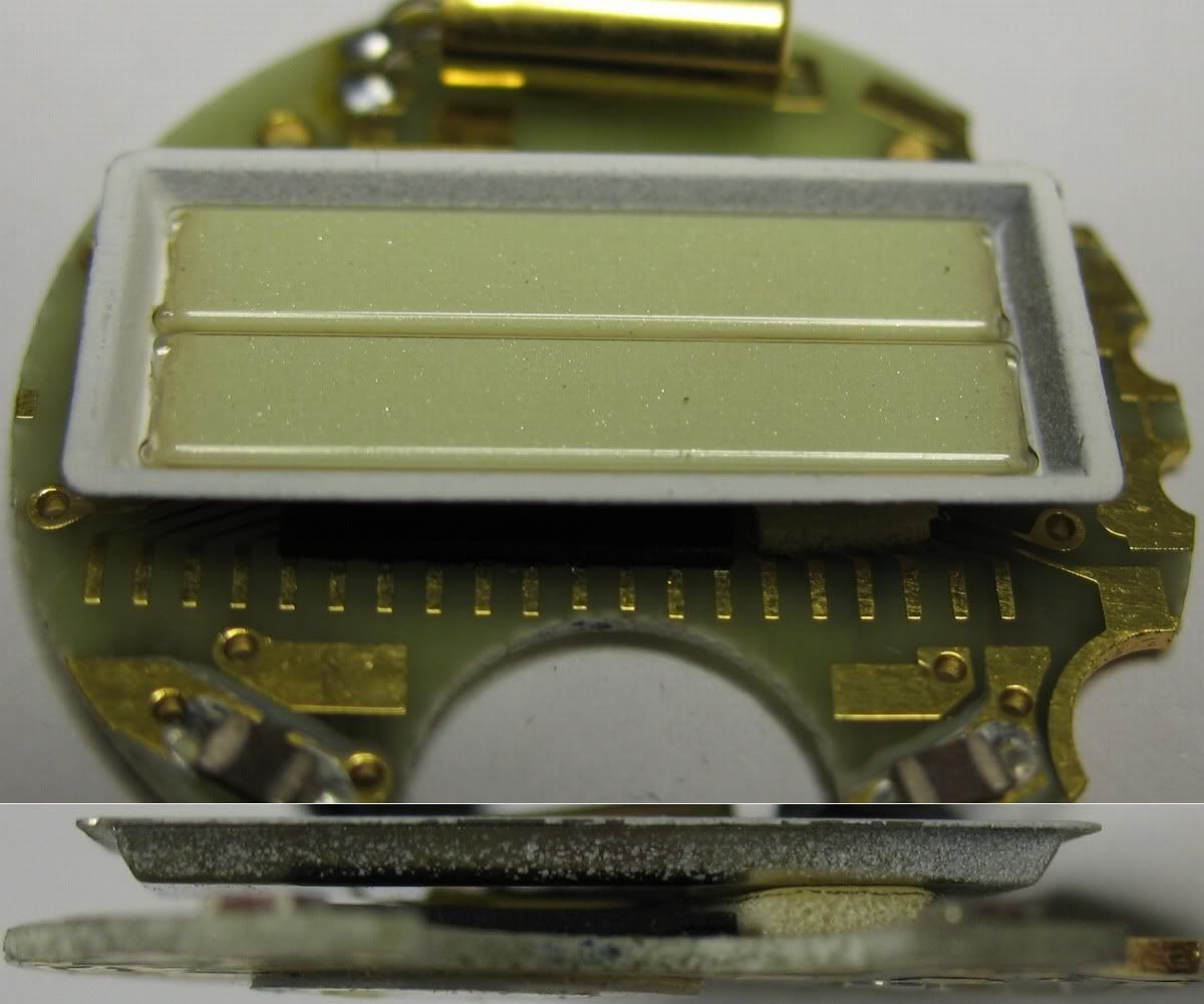

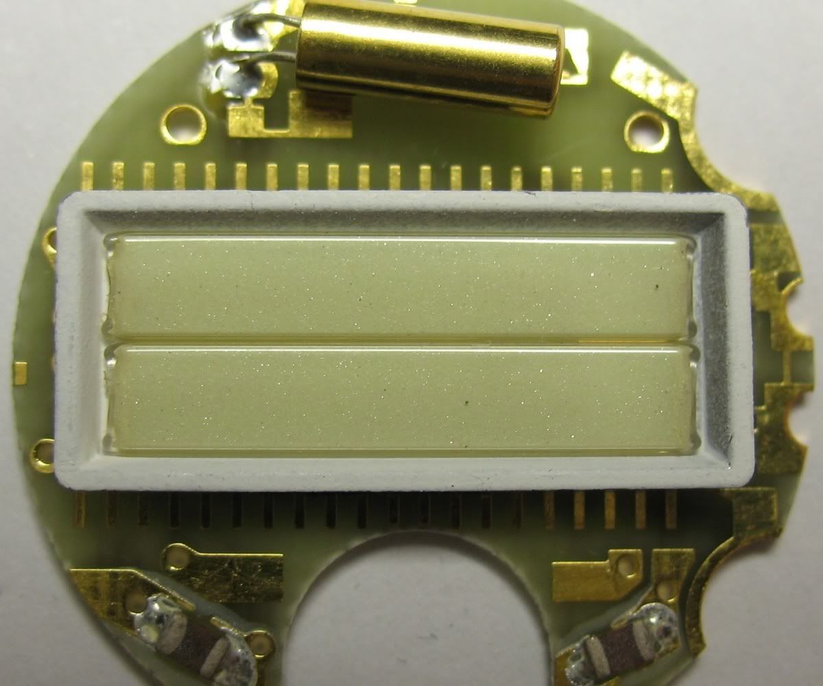

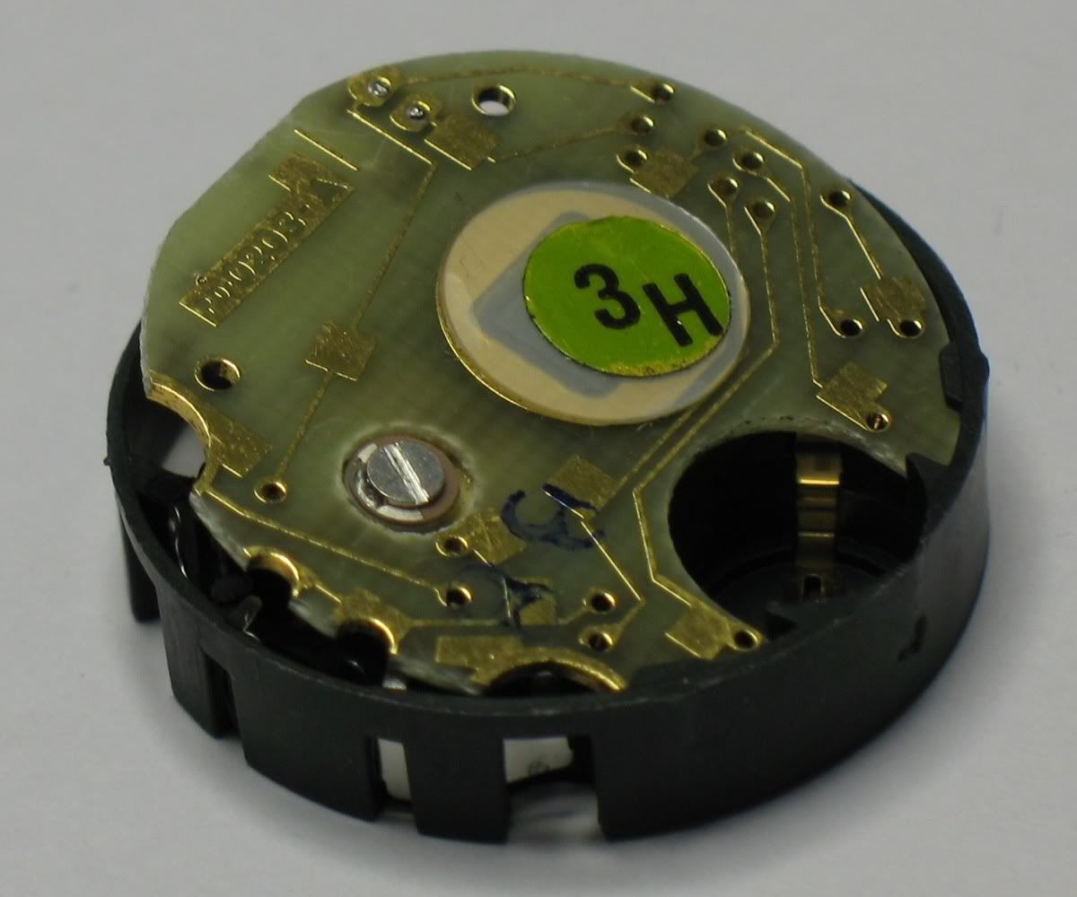

2 vials, 18mm x 3.4mm x <1mm each.
20mm length would just fit, but not in the original vial holder. I'll post some photos later.

2 vials, 18mm x 3.4mm x ~1mm each.

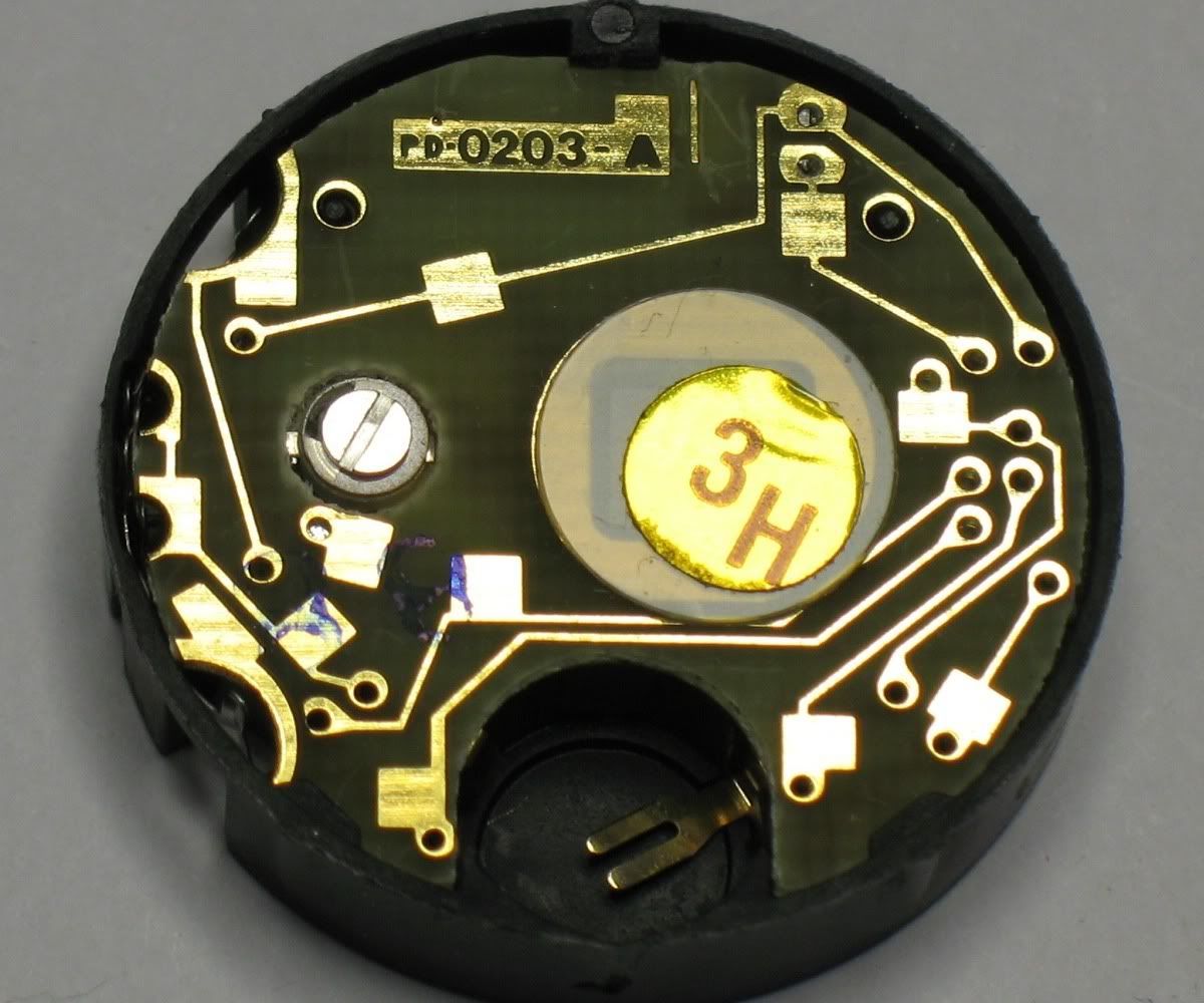

Click images for full size:
The LCD is direct driven (not multiplexed), 39 segments + 1 common.
Note the two extra segments between the seconds digits - they are used for the nice DOW display (M,Tu,W,Th,Fr,Sa,Su).

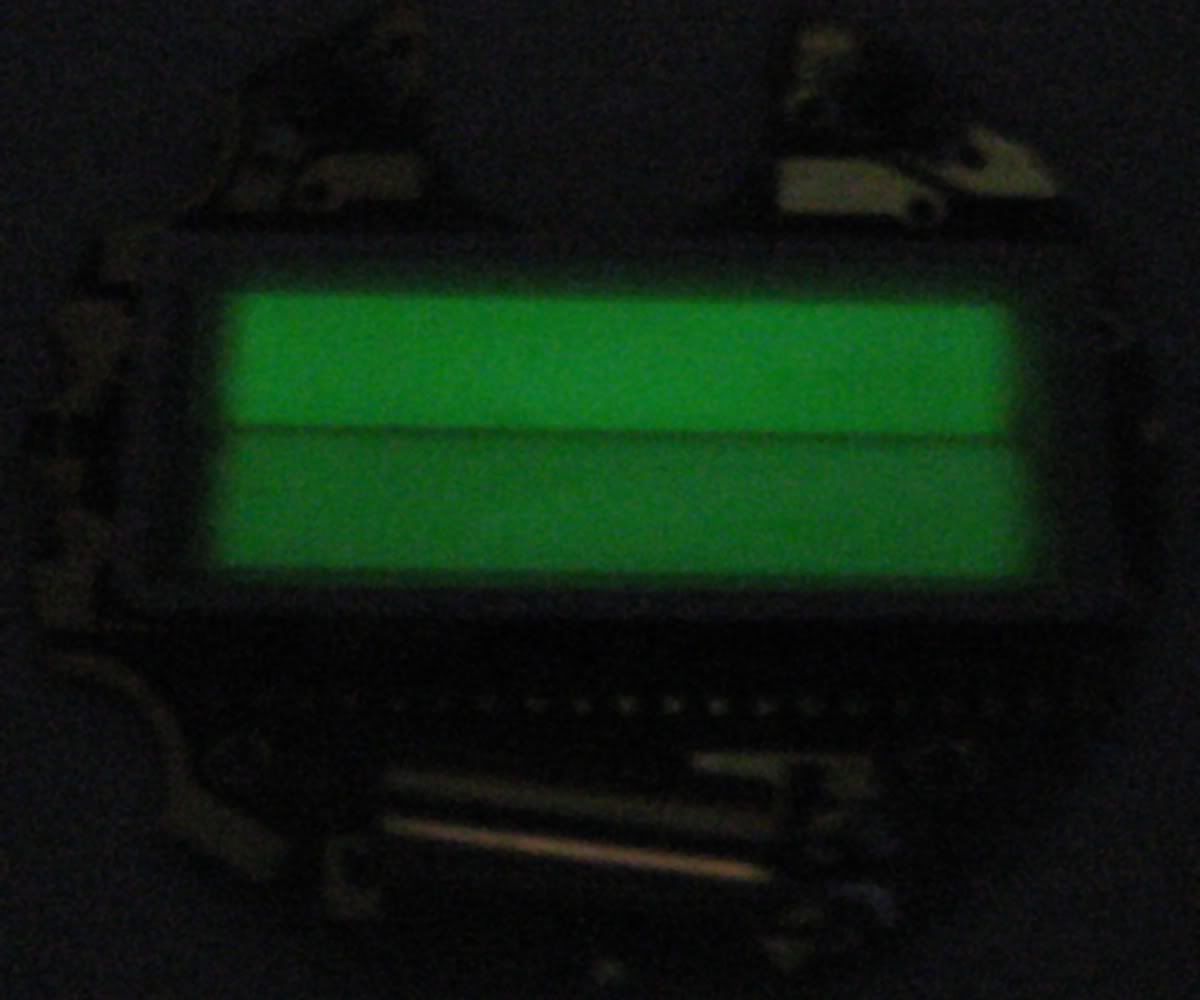

The "glow" photo was made with 15s exposure time @ F2.8 and a rather poor camera.

After seeing that vial holder tray I think it may be better and easier to fill it with Glow Inc's glow powder mixed into clear epoxy.

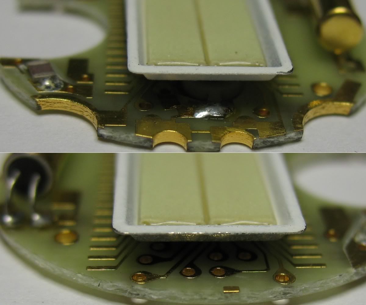

Post10 Jun 2010, 03:42
Hmmm, this is promising...
The tray holding the vials is 20mm wide, so clearly the vials will need to be 18mm or so to fit in the little tray:
However, the little tray seems completely optional. It fits neatly in a little space in the module behind the display. So, it seems that the 20mm vials could be placed in that space minus the tray with no problem:
How much do the 20mm tritium vials cost?

The tray may not be needed but it might be helping reflect or direct all the glow toward the LCD.
Does it look like thicker vials could be used? The round vials are much brighter and easier to get. They are smaller but we could install more of them.
