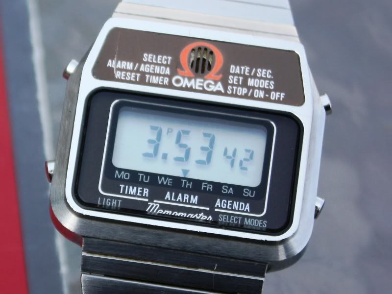

More like the 1632 omega?
(pic from a sold memomaster found on web)
Re: Tissot F1 lcd
Post21 Sep 2012, 07:11
Oops :oops:
Yes, quite right. 1632 is what I meant.
