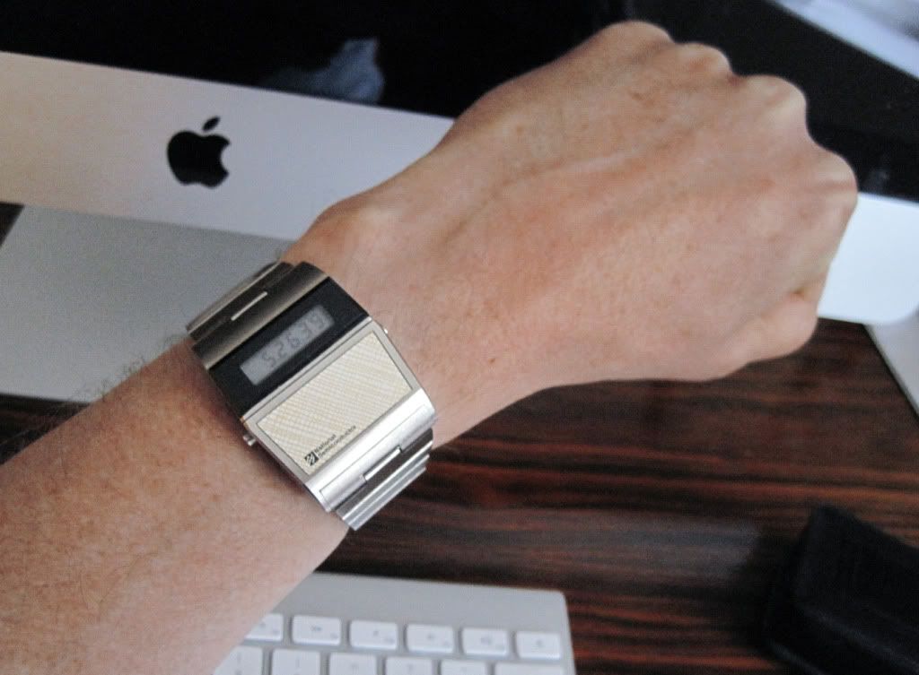

Here is a photo of the watch, hopefully someone can help me now.
Any help appreciated. Thank you.

Thanks seicitizitch :-D You're right, it really is a very nice watch, and I'm very happy with it. It just sucks that I can't get it to work.
I actually do have an original bracelet for the watch. I've attached a photo with it on.
I'm going to assume that Digibloke is right on this one, and that the watch doesn't have a place to "AC" it. That's unfortunate.
Someone else has made a suggestion to remove the module and try running it outside the case. I think I'll give that a go tomorrow. Any advice for removing the module is appreciated.

Here's a quick pic of mine...
