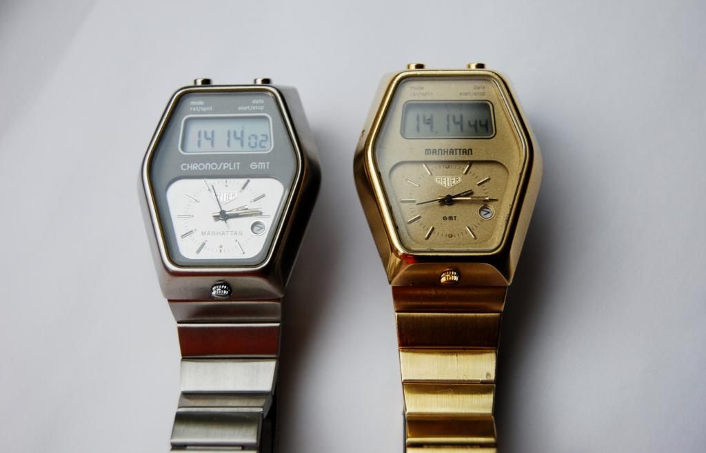

Hi guys,
I got this Heuer Senator not too long ago and I'm definitely in love with it. Unfortunately, all my love is not been retributed :eek:
I got it as described on-line, the analog movement is working perfectly but the LCD part refuses to fire up.
I cleaned it carefully but I believe that it needs more than TLC. (I will polish the crystal, band and case after).
Any suggestion? I wouldn't mind "adapting" another LCD module just to see it working again and keeping it for my personal use (as I mentioned on this forum previously I don't sell my watches anyways).
Also, it is missing one button (replaced with the wrong one) and the clasp any idea where I could find it?
Any help, advise, tip, etc etc is more than welcome.
Thank you :Hi:

I owned a manhattan recently with a dead LCD movement. I have disassembled it to find that the chip was loose and the bonding wires were all gone (some were floating around in the space between pcb and lcd panel).
The chip with its bonding wires is NOT protected by a dot of resin or glue, which makes it extremely (!) vulnerable. Be véry carefull when disassembling the movement.
Judging your picture i think your lcd panel should be functional but the chip or a few bonding wires came loose after one or several falls of the watch. Most senators and manhattans have dead lcd movements.
Goodluck, you do have a valuable watch despite its damage of movement, crystal and pusher. Would probably do between 175-400 usd on the bay.

But just thinking about opening and removing the LCD to have access to the chip and its bonding wires makes me nervous already :-( and even if I can see and/or diagnose the fault I will not be able to weld/glue it. Isn't the wires the ones that need to be welded with micro-ultra-high-super-dooper-very-tine-small-microscopic ultrasonic machine?! :scratch:
So, for now I need more time to think about it (and get more confident to open it) :grin1:
But it sounds very plausible your comment.
Thank you very much for your advise/diagnostic.
I will let you know whenever (if ever) I open it the end result :-D
