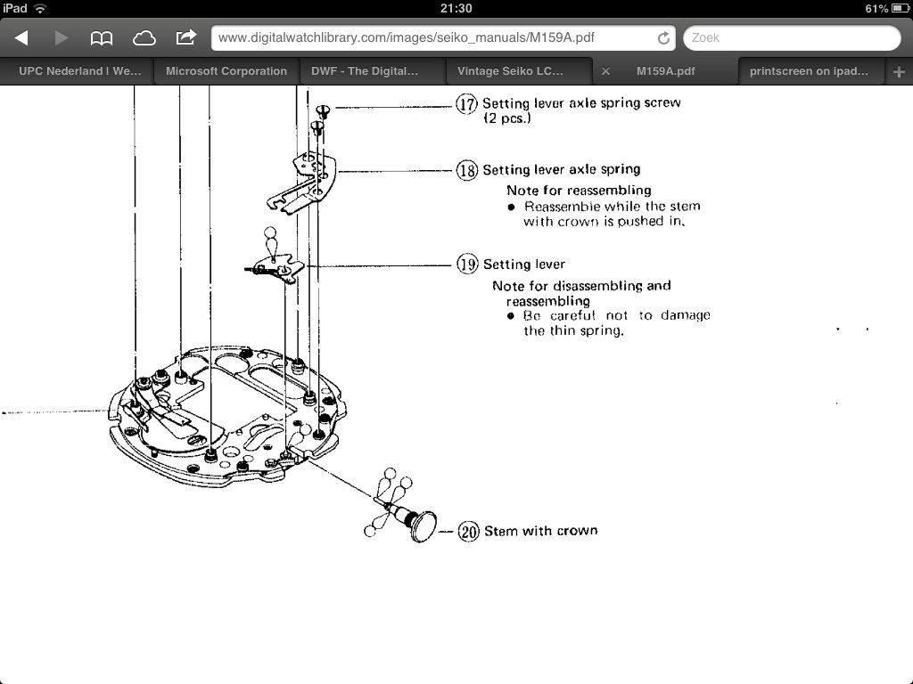

I then stumbled on the digitalwatchlibrary website which had a tech guide for this watch.
Read it and i localised what i thought might be the problem.
Using this:
I started on opening up my non repairable Seiko as i could not do much damage to it.
As most screws were rusted because of water damage it turned out to be quite difficult.
Eventually i succeeded and i got the part i thought i needed and it was still good.
It is part #19 the setting lever.
Building up my confidence i started to take apart my partially functioning Seiko.
Sure enough it's setting lever was broken, replacing it with the salvaged part.
I put it back together.
Now it is a fully functional Seiko M159 5095, and i am so pleased it is a wonderful watch.
