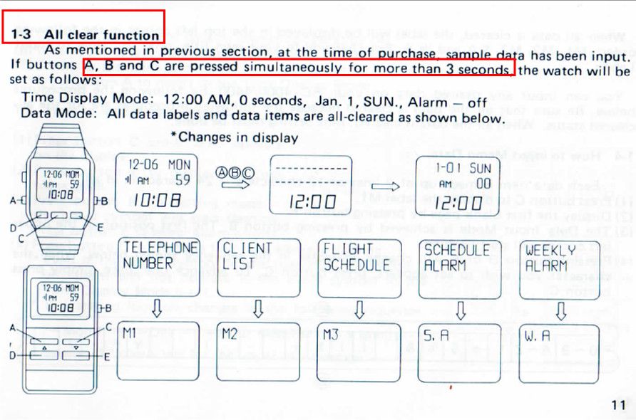

Thanks for the advice :(, but what if my watch (for example) would not had such a label inside the caseback, since Your attached image cannot be seen? :). After all, at the watchmaker check, my watch had the inside label, but I really don't understand why so much cautions from You to CLEARLY present this straight solution, since it is already a very rare watch and the same thing it is written in the manual, but not very clear for everybody!
I would have been much more thankful if somebody would have clearly told me the below-presented simple solution I've asked for ( in my post above about ABC simultaneous buttons combination for RC 4000/4400).
ANYWAY, below is presented the solution I was asking for - after all, and as I suspected, the solution IS THE ONE presented in the manual of the watch, tried and verified during the "revival" of this vintage and outstanding watch with my watchmaker:
I was with my watch (Seiko RC 4400 PC Datagraph) at my excellent watchmaker, so - after the proper battery replacement - it is now working like a charm :).
If I will have some time I will post some more photos of this NOS RC-4400 and/or I will make a full review with (hi)story :).
Some advice for other users:
If the battery was removed for a long time, after battery replacement the watch may display a "garbled" screen and/or will sound continuously.
Thus, to make it crystal clear for all current or future users of such watches: The "magic" solution to this problem is to press SIMULTANEOUSLY the A-B-C buttons combination for few seconds (3-5 s), that will do an AC (All Clear) reset of the watch, as it is mentioned in the manual page shown in the picture below:
So, the regular ALL CLEAR reset for the data will also perform an AC reset if the watch may function strangely AFTER the battery replacement!
It's a kind of "magic" ... :mega: :grin1:

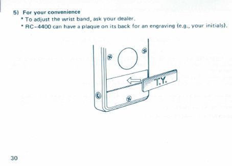

As I've already told You, the watch is NOS (it even has the sealed pack containing the original Gold Plated plaque that may be glued on the caseback, where the owner may have his initials eventually engraved on it - pls see the picture below :grin1: ), so I simply didn't want to do something that may ruin it, without the proper knowledge.
Anyway, now Your excellent picture of the watch case back note can be seen by regular forum's users, finally.
Many thanks for all Your kind help. :Prost:

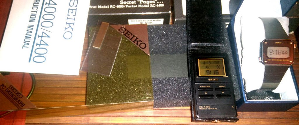

A new photo of my Seiko RC 4400 Pocket Terminal (now working - after the battery replacement and the "magic buttons combination" described above) :grin1: , together with another recently acquired watch, that I was searching for from a long time:
Seiko D031-401A, the first DOT MATRIX display watch (1980) - and I may write a review later, about WHY this ""proof-of-concept" was a major achievement for Seiko, but also for other High-Tech companies from Japan, at that time :grin1: .

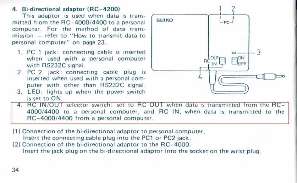

What I have found quite interesting is the fact that RC 4000/4400 Pocket Terminals were able to transmit/receive data BI-DIRECTIONAL, not only from one watch to another, but also TO/FROM a computer, by the means of a battery powered BI-DIRECTIONAL adapter (adapter SEIKO RC-4200, using Manganese dry battery S-006P 9V), as one may see in the picture below, from the original user manual.
So these may be the first watches in history able to do a wired BI-DIRECTIONAl serial communications for data transmission, between them and/or with third-party computers! :grin1:
So a business man was able (in 1985!!!) e.g. to schedule the future meetings on his computer, upload them to the watch and after that to share them from the watch with all the employees'' computers!!! :eek:
Does anybody know about/own or at least personally seen such a Seiko RC-4200 bidirectional adapter??? :scratch:
