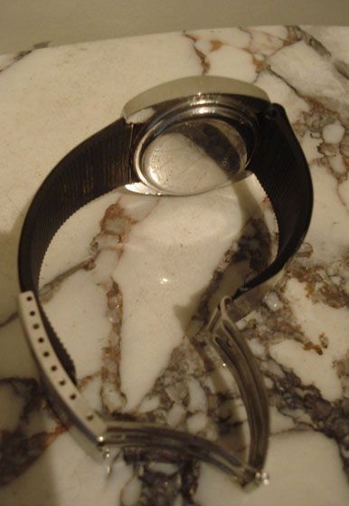

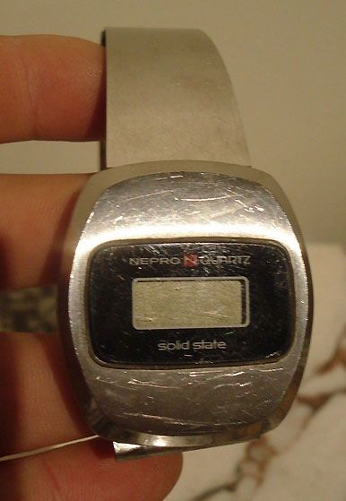

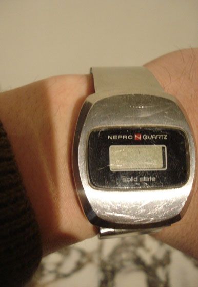

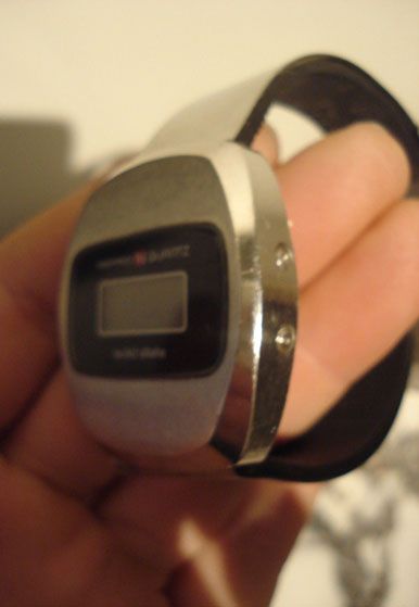

Hi friends! After the big disappointment of the Avia/Optels (a new module from Greg Zanoni is my long-term project), I wanted to get past the grief of that loss with another acquisition, and I managed to win this Nepro on the 'bay from Belgium. I don't know if I'm luckier this time, but the watch is untested, so I keep my fingers crossed, hoping that works and doesn't have the old batteries inside.
I've checked out the pictures carefully, and it seems that it doesn't have a Microma module, but an MSA one, since the "Microma Inc." text is missing from the caseback.
As you can see, the watch has been used a lot before being abandoned: the case is slightly scratched and would need some sandpaper job in order to come back in good conditions, and the internal rubber part of the bracelet detached from the external steel frame, so I'd have to glue that part back in its place. Here are the pictures of the watch:
I got a little question about the module though. From what I've seen on the web, it seems that the ESA 9312/9315 and the MSA module share the same buttons layout. So I guess that I could retrofit an ESA 9315 into the case of the Nepro? I wouldn't be able to use the light but at least I could use the watch in case the module doesn't work.
Fingers crossed, waiting for its arrival and hoping that it won't require the magic of a Nepromancer, in order to be resurrected... :grin1:

About the bracelet, are you sure it's not the original one? I've checked out Piotr's site and I've noticed that his Microma DSM has the same bracelet (picture source Crazywatches.pl):
I'll replace it with another one, as the rubber part detached from the steel one. I'll see if I could glue it back to its place, maybe with some sylicone. ;-)

That's interesting, Quietman! I guess that yours had the date feature or the light?
Mine seems to have both recessed buttons, so it might adopt an MSA module or a variant of yours. :-)

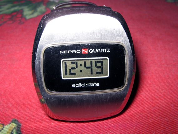

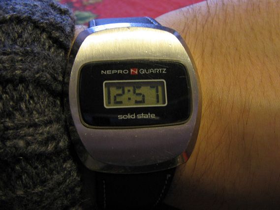

Hi friends! I went to the watchmaker this morning, in order to see if he managed to open the watch. Luckily, he did, and there wasn't the old battery inside. He said that the module was pretty clean and oxide free, and when he plopped the new battery, it fired up immediately, with its clunky-looking digits. It's a Microma! And it lives! :-D
The contrast is excellent for its age, the digits look crisp and neat, and they're very easy to read. It seems to keep good time too. I've replaced the old broken bracelet with a new leather strap, since I've noticed that I can put only leather straps or bracelets with curved ends, due to the shape of the lugs.
I've also received the watch that we were going to use as a donor, in case the module didn't work. It looks very nice, so I put a steel bracelet and I will wear it on rotation. Thank you for the swap Martin!
So this story has an happy ending, at least: I got my first Microma, made a new friend on the forum, and an apparently non working vintage watch has been brought back to life. Life's beautiful. 8-)

It also looks very awesome with that black leather strap, that was a pretty good choice! I guess after all this watch was a true bargain for such a historic piece. 40 years later and it makes someone happy again... :-D
Re: Nepro Quartz Solid State: Nepro or Nepro-mancy?
Post18 Dec 2013, 23:53
fronzelneekburm wrote:It also looks very awesome with that black leather strap, that was a pretty good choice! I guess after all this watch was a true bargain for such a historic piece. 40 years later and it makes someone happy again... :-D
Thank you Fronzel! I'm quite happy to know that works amazingly as it did 40 years ago, as I didn't expect to see it working, due to the price I paid for it. I'm checking its accuracy with an NTP clock, and seems that it runs a lil' fast: it gained seven seconds in three hours. Can't complain about it, I'm already glad that works without any problem. :-D
