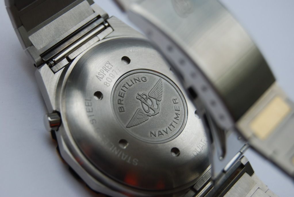

I'd also like to get a caseback wrench for it. This one has 14 edges, but all the ones I've seen have 15 edges. Anyone have any good ideas ?

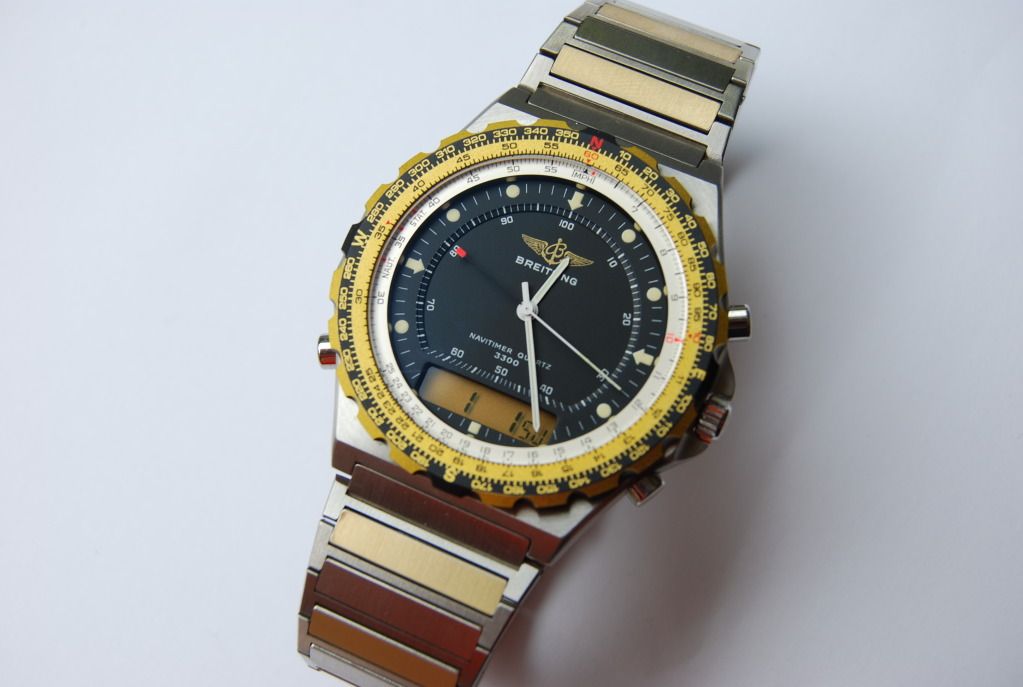

Hi Charger, great watch, i too obtained an Iranian 2300 a few years back and like yours, mine was faulty (analogue part was fine, lcd did random things) i sent mine to Dr Peter Wenzig and he repaired it.I've seen Iraqi, Iranian and Saudi versions. Mine is one of the most comfortable watches i own and i wear it regularly. Regarding the caseback, i opened mine using one of the cheapo adjustable wrench spanners with the interchangeable heads .The set contains a pair of flats that should open it as long as it aint mega tight. Or you could try one of those ball openers maybe ?
I also have the later version, the 3300, that one was gifted by The Sultan of Oman and is new old stock. The caseback on the later model has holes in it so is easier to open. The Navitimers are all fab imo

The caseback was loose when it arrived, so I only need the wrench to tighten it right up. At the moment it's only finger tight.
