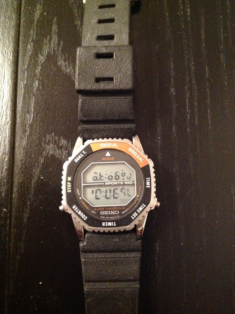

A while back I acquired a very nice Seiko A829-6029. Unfortunately, when I recieved it I found that the display had some blank spots, so some displays were hard to read. I made the mistake of taking the watch to a local watch repair shop - they made it worse - now everything is garbled. THis is really my bad, as I should have known they weren't up to it.
So, my question is, are there any reputable experts who repair these vintage beauties? I really love the watch - the case is really nice. I'd like to get it repaired.

Freakin idiots.
Visually (without having it in my hands) it appears to be the contact zebra strips connecting the LCD panel to the PCA (the display to the mother board) and not the display driver.
A simple fix but requires the panel to be removed, the strips cleaned, contacts on panel and PCA cleaned. All dust removed before reassembly.

The plastic carriage is also frail so make sure you are careful. The strips have to be put back in the right way round also, as over the years the will have become slightly indented from the contacts below. Although it's agreat watch externally its not one of Seikos best quality constructions, flimsy to say the least.
Seiko&Casio Lcd's
  • Posts: 314
  • Joined: 02 Oct 2012, 10:54
Re: Advice on Seiko A829-6029 repair
Post03 Jan 2015, 14:05
As Adam stated, the "watchmaker" maybe cleaned the zebrastrips , but were put back in the wrong way.
That's why it's all garbled now. I hope you didn't pay for his "services" :bang:

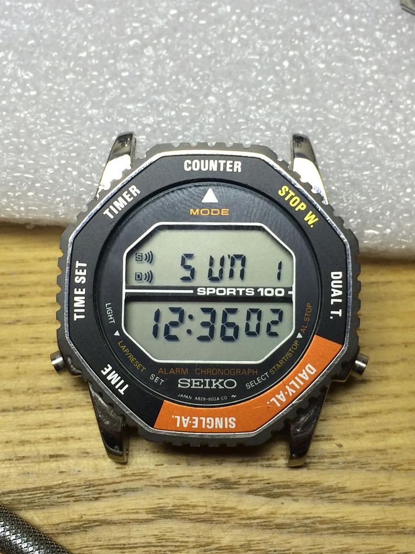

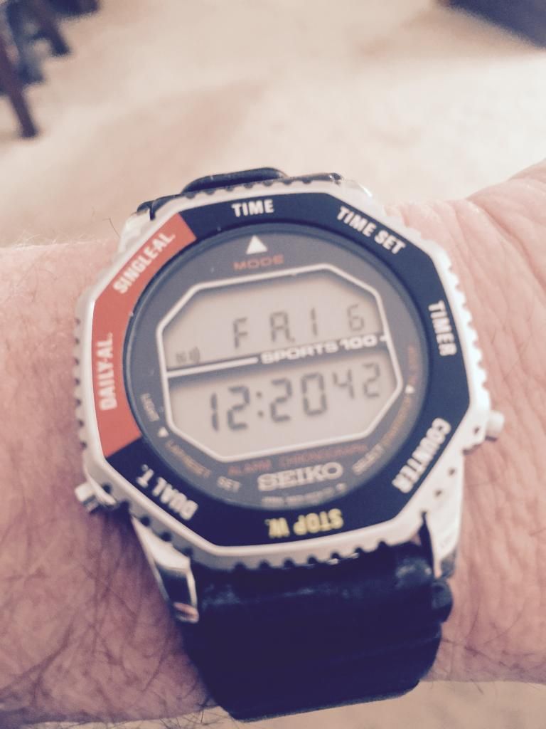

Post07 Feb 2015, 05:55
Happy update. After I posted, I had a discussion with Seikokid and he agreed to repair my a829. I sent it to him and he worked his Magic. He fixed a number of issues with the watch, the most serious of which were with the LCD. It had been installed incorrectly (upside down) and was failing as well.
It now looks good and runs well. Thanks Rob!
