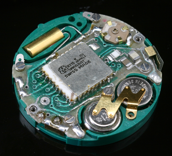

Can you post a bigger picture of the Sandoz? To me it looks like it has a rotten battery contact, and the contact also seems to be in the wrong position.

Post21 Jun 2013, 01:34
Sure can. This shows a lot more. I never thought of doing this, much easier than using a magnifier.

Hello John,
Plato wrote:Sure can. This shows a lot more. I never thought of doing this, much easier than using a magnifier.
Thanks. I can see signs of leakage on the lower battery contact. Unfortunately the contact that goes over the batteries is missing in your picture. It should look like this http://www.schild-eterna.de/bilder/armbanduhren/9315%20%20ESA.jpg and it should be held in place by two screws (the lower one missing on this picture). On your previous picture it looked like only half the contact is there.
