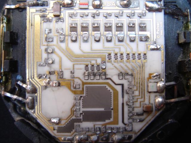

Time to lay the urban myth of the thick film resistors on the P2/P3 boards being "thermistors" to adjust the frequency to rest.They are not that, what they are are twofold- the ones just below the LED drive transistors are current limiters (no big mystery there), the big labyrinthine ones in the oscillator circuit (under and beside the main chip) are parasitic oscillation stoppers, RCA recommended adding these when (misusing ) digital inverter stages as oscillator stages in early A series CMOS. Think for a moment, if you could adjust the frequency of a crystal oscillator with something as simple as a resistor why would you fit two variable capacitors to do this to your circuit board (far less reliable). However the real reason for printing these resistors on the board with the shape they have has not a lot to do with the resistance value- they are there to add a few nano-Henries of inductance to the circuit to make sure the oscillator runs at the fundamental frequency and not an overtone (CMOS circuitry is voltage switched and a few hundred thousand ohms or less of resistance makes b*gger all difference to the actual operation, notice how the main bias resistors in digital watches are always in the megohm and higher region). And why print the labyrinthe resistors on the board rather than just laying down a trace in the same shape, well, you do need some resistance to limit the back voltages induced by the self-inductance frying the very delicate input gate in the oscillator, no resistance and you might get enough volts to puncture the junction.
So, comments please :-D

here is a detailed analysis of my expert friend performed on a handful of dead and working modules.
tested at 30ºC and 80ºC giving a variance of 1% which is in spec for a precision resistor = not a thermistor.
fell free to discuss and correct my technical translation if required.
symbol / type / value at 30ºC / value at 80ºC / resistor designation
R1 / SMD / 22,1MΩ / 22,2MΩ / parallel for oscillator
R2 / sputtered / 470Ω / 473Ω / serial for oscillator
R3 / sputtered / 439Ω / 441Ω / serial for emitter
R4 / SMD / 1,0MΩ / 1,07MΩ / parallel for lightsensor
Rb / sputtered / 2,22KΩ / 2,23KΩ / serial for base
Rc / sputtered / 75Ω / 75Ω / serial for collector
Rx / sputtered / 88,4KΩ / 89,1KΩ / pull-up -Uz
Ry / sputtered / 86,9KΩ / 87,4KΩ / pull-up +Uz

Are these tantalum nitride resistors?
: Suitable 32.768KHz oscillator for Pulsar Modules...read on
Post10 Jul 2010, 20:12
I'm not sure if such a detailed analysis is possible. they don't taste like tantalum ;)

azimuth_pl wrote:here is a detailed analysis of my expert friend performed on a handful of dead and working modules.
C1 / SMD / 27pF / not tested / fixed for oscillator
C2 / SMD / 2,7nF / not tested / lightsensor circuit
A very interesting and informative post. Thank you.

The video linked in Handy's post says at 2:57:
... Laser beams are cutting apart the resistance networks that will be used to regulate each crystal - each one a network of fifty (of fifteen?) tantalum nitride resistors, the most stable resistance material known. Each network evaporated onto a ceramic substrate ... and connected with gold conductors...
There are 15 printed resistors in azimutp_pl's picture, plus 7 under the display (eays to spot in the video), makes 22 - neither 15 nor 50.
Resistance networks to regulate (adjust?) the crystal? Or does "regulate" here rather mean "operate"?. In the next scene they describe the trimmer condensers.
Post10 Jul 2010, 22:22
now I recall :)
that print screen is from the Pulsar promo video I digitilized years ago on disc.
so it has to be tantallum nitrade resistors evaporated onto the ceramic substrate.
I used the word "sputtered" in my description as it is quite equal in sense and found in electronics terminology.
there are exactly 15 if you only count the spiral ones, consider Ry as two separate and include R3.
those 15 are clearly marked with a darker color on the diagram in the video.
that means that the rest can also be sputtered but not tantallum.
I'd say that "regulate" means "operate".
the whole concept is based on elementary knowledge:
http://en.wikipedia.org/wiki/Pierce_oscillator
this is a more detailed pic of the ones under the display:

Does this vindicate my assertion those are temperature sensors or not? Great pictures and information you guys found - damned impressive!! 8-)
On the testing, it seemed to me the greatest change was between room temperature(22c/72f.) and body temperature(36c/98F). I can't imagine many watches being exposed to 80c. Unless left on the dashboard of a car in summer, which would probably lead the batteries to leak. Most electronics kind of crap out at that temperature range, not sure the Pulsar engineers tried to cover that range.
Tantalum, sounds like some cool Russian vodka. Or maybe a death metal band. NO - it is this band of hot chicks from Australia!!
http://www.myspace.com/tantalum
RWAR - talking about wanting to visit down under! :O`~
Post11 Jul 2010, 01:56
not sensitive to temperature in technical terms thus not a thermistor.
usually extreme variables are taken into consideration for testing purposes but as shown the high temperature did not impress the patient :)
btw. the largest quantities of this rare metal is in.... Oz!
