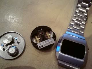

Post09 Dec 2009, 00:25
Here's the pic:
  • Posts: 971
Re: : trafalgar module
Post09 Dec 2009, 01:47
steveh wrote:I'll put up a pic of it as asap, it is an ns module.
where about are you in scotland
Thats the one, its a very easy fix if your used to using a soldering iron if not I can do the repair for you if needed.

: trafalgar module
Post09 Dec 2009, 12:46
Hi Klippie
that's kind of you. I'll nip own to maplin and buy a crystal. If I get stuck I'll let you know.

: trafalgar module
Post09 Dec 2009, 15:44
HI klippie
it appears to be totally dead now, I've not yet done anything with the crystal, arghgh
  • Posts: 971
: trafalgar module
Post09 Dec 2009, 19:27
Change the crystal over anyway they are only 50p it'll probably be just fine.

: trafalgar module
Post10 Dec 2009, 19:03
Hi Klippie
success! It now works fine. thanks for advice
