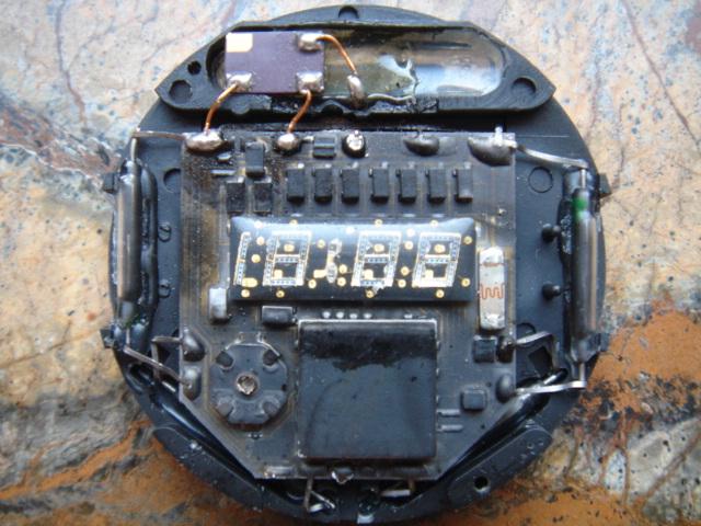

Having recently acquired a dead Hamilton LED with a P2 type module, I thought I'd look into it a little deeper.
It had the usual single bright digit fault, so I tried a new crystal but to no avail.
My next test was to place the watch on a radiator. It sprung back to life! The temperature compensation resistor must be O/C.
I now knew that a CMOS oscillator IC was required. The best and cheapest one I could find was made by Epson and draws just 2 microamperes. It was cheap enough at £2.07 + VAT.
Anyway, I bought 5 and tried one out with excellent results.
Will keep you all posted.

Hi Abem,
I would try changing your crystal first. If that doesn't work, the fault will probably be within the IC.
I fitted an oscillator 24 hours ago and it is still running with no timekeeping errors. I have worn the watch all day.
Here's a link to where I got them from:
http://uk.rs-online.com/web/search/sear ... &R=4785064
It's a very easy job to undertake. All you need to do is find a positive and negative connection on the Pulsar board. The oscillator output is connected to the left hand crystal connection point. The original crystal has to be removed to make room for the oscillator. +ve supply is taken from the top left hand pad on the module, there is a reed switch soldered to the pad. -ve is taken from the trimmer on the back of the module at the far end from the adjustment screw.
Pins 1 and 4, of the oscillator must be connected together.
Cheers,
Ian

Post09 Jun 2010, 23:22
OK, I've just done a hamilton QED module.
I've fitted a 33K resistor on the output, of the chip, to limit the current driving the module chip.
Here's the photos.
This watch had not been opened for many years and still contained the original batteries. It's in quite nice condition, so I've decided not to rob the module and to use it.
I'll post some photos in the relevant section of the forum, this weekend.
Cheers,
Ian G1DRP

Handy - small suggestion on your connection technique. Do your utmost to not solder to the board. You were lucky, those traces often lift off from the heat of soldering. And why expose any of the other parts to the heat. I realize the lead may have came off and you had no chioce - been there, done that. :x

retroleds wrote:Handy - small suggestion on your connection technique. Do your utmost to not solder to the board. You were lucky, those traces often lift off from the heat of soldering. And why expose any of the other parts to the heat. I realize the lead may have came off and you had no chioce - been there, done that. :x
I needed to solder the +ve supply to the board. Heat was applied very briefly with an 18W iron and I used tin/lead solder.
I'll be cushioning the chip in black silicone rubber tomorrow evening.
