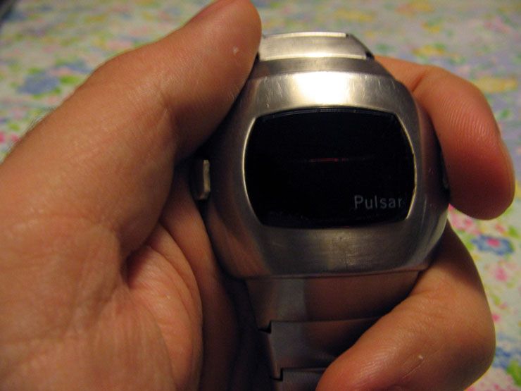

I just got the P3 this morning, it has good cosmetical conditions, but unfortunately the watch shows the "dreaded single digit of death", only a "0" which lights up by itself and changes position everytime I put the batteries. Sometimes it happens to have little accidents like this one. So now, it's time to save money to make a SASM module for it, and the P3 will be resurrected. ;-)

vpn wrote:I just got the P3 this morning, it has good cosmetical conditions, but unfortunately the watch shows the "dreaded single digit of death", only a "0" which lights up by itself and changes position everytime I put the batteries. Sometimes it happens to have little accidents like this one. So now, it's time to save money to make a SASM module for it, and the P3 will be resurrected. ;-)
I would explore the possibility that the QC is faulty as the single digit display is an indicator that it has gone bad, it could have other issues but it is cheap to replace the QC so well worth a try.

Indeed, after all the reason of the "single digit of death" could be the oscillator or the QC, but since I'm not an expert in electronics (I can't even handle a soldering iron, my hand shakes too much :lol: ) I'll send it to Hanno, so he can find out if it's just a quartz issue or it needs a SASM. I just have to save the money now, so it can be sent to the LED Hospital and resurrected by the Doctor, with a new quartz or a new SASM heart. :-)

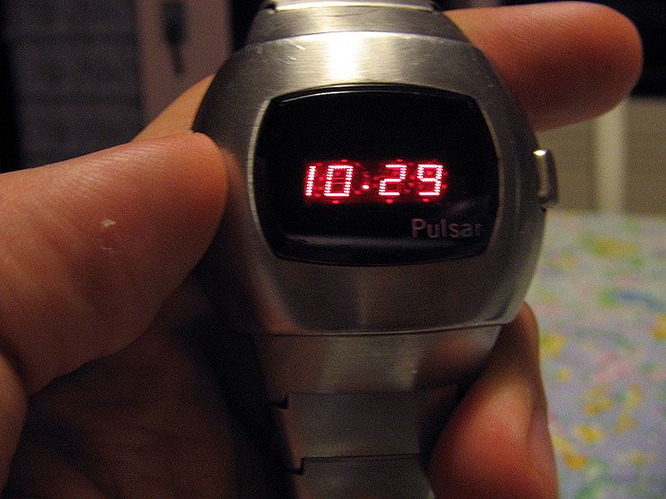

I just got the P3 this morning from Hanno, and it works perfectly. I can't stop thanking Hanno for his amazing work. Without his passion for LED watches and his intensive work to resurrect them, I would never be able to wear it working. Thank you very much Hanno! Here are the pictures of my P3, which is now alive! :-D

Ohh I love it so much! Especially because it behaves exactly like the original module. Some minutes ago I've just bought a package of 10 Renata batteries, so I have a good stock of batteries for my baby. It's gorgeous! :o

The only "issue" (which technically isn't an issue, I'd be too much nit-picking :-P) at the moment is that sometimes there's a little delay before the time or date is showed, after the button is pushed: sometimes it lights up immediately, while some other times I have to keep the button pressed a bit more to display the time or the date.
I wonder if a good clean with some isopropyl dripped inside the buttons could fix this little issue, just like how Ed suggested in an old thread, otherwise I can live with it, waiting to get used to that. ;-)
