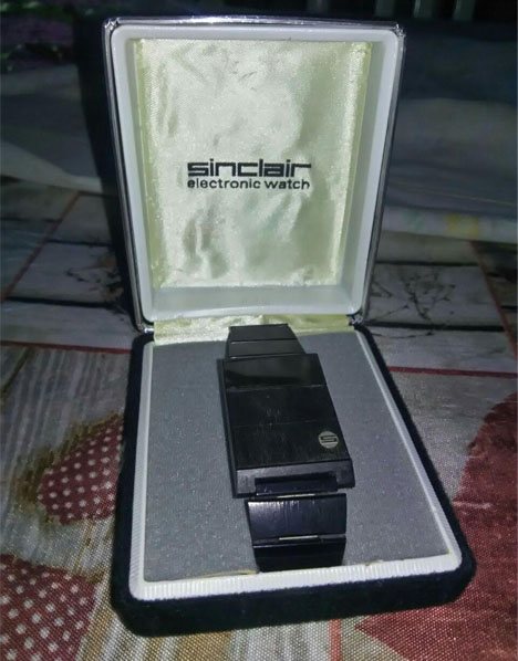

It seems sometimes I can be quite the masochist, so I've involved myself in yet another Russian roulette, four years later. This one, however, is in much better condition (pristine, I'd say!). The seller has not tested it and hasn't even checked the battery compartment, so my heartbeat is going to be accelerated until the day of its arrival.
On the flipside, besides the excellent visual condition and the presence of the original box (which seems to be quite well preserved, as well), this one is the so called "Limited Edition" with the metallic S emblem and the supposedly more reliable module with the DOW feature. Fingers crossed. In case it won't work, I won't flip this one, but get a five digit display and send it to Hanno for a rebuild.

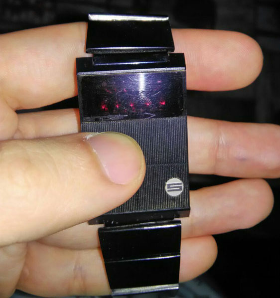

Well, the Russian roulette is over. I got the watch today. Aesthetically, it is in amazing condition, just a little grubby due to finger contacts, some elbow grease with isopropyl alcohol should fix everything. On the other hand, there were the original Union Carbide mercury batteries inside, which suffered of a very limited leak, that I have cleaned with a fiberglass pen.
Much to my surprise, after putting two batteries I scavenged from another watch, it works! But... Only the setting button works. The front ones do not respond to any command, which makes me guess that the foam that holds the aluminum pads responsible to make contact with the module, has degraded and so, there's no longer contact. I already have messaged Hanno about this, as I do not want to open it myself (being the case made in plastic and knowing that my hand is everything but steady), and so, I will send it to him in order to make new pads and restore the functionality of the buttons.
In the end, I finally won this Russian roulette, even though it took four years before I did, but it's not over yet: the Black Watch will need to go to the watch spa in Germany, before it'll be fully healthy. But at least, it woke up after a long sleep.
EDIT: The module has croaked today. As most likely there's no hope to repair it, I have bought a brand new HP five digits LED display, so once it arrives, I will send both the watch and the display to Hanno in order to rebuild the module.

And finally, the Black Watch is finally back to Italy, after getting the SASM treatment. For the first time, yesterday, I have worn a little piece of British electronics history. I am very, very, very excited, because not only it is in very good condition for its age, but because it sums up the wish of the major electronics companies of the era, that wanted to create the most innovative digital timepiece ever. While the Black Watch kind of missed the train with such things, due to its legendary unreliability and poor construction, it is undeniable that sir Clive's genius has left to us probably one of the most beautiful LED watches ever made, in my humble opinion. And I am going to wear it with pride, as a statement of British elegance.
I simply love its design: timeless, iconic. You couldn't find any other LED timepiece with the same styling back then, and the idea of using a touch panel instead of classic command buttons, was way ahead of its time. Who knows, maybe when the pandemic will be over and I'll be able to go out once again, people might confuse the Black Watch for a modern smartwatch. That is going to crack me up, in the moment I'm going to tell them it's from 1976. And who knows, maybe one day I will also be able to find a "classic" Black Watch too, to pair it with this one. Only time will tell... :-D
