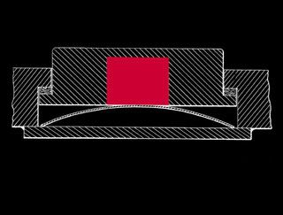

The first button assembly was invented by John Bergey. The early Pulsar watches unutilized a Platinum-Cobalt (PtCo) magnet. PLACOVAR was a company trade name for the magnets used in the button assembly. Placovar was a product that came from the Military Division of HMW, which is where Mr. Walmer worked. These small powerful cylindrical magnets produced an average of 1.300 gauss and were pressed into the button vertically, or perpendicular to the reed switch. Although the drawing below shows the magnet in the center, it was offset to the right (looking from inside the assembly) to better align with the reed switch. Both button assemblies used a Million Cycle Havar spring.
Again, Rewolf is correct in that Samarium-Cobalt magnets were used in the latter buttons. PtCo was used until Arthur O’Connor invented an improved button assembly for Time Computer. Using an epoxy to fasten the magnet to the spring clip in the horizontal position, there was no longer a need to press the magnet into the button. This was a much more economical assembly and these magnets were very reliable.

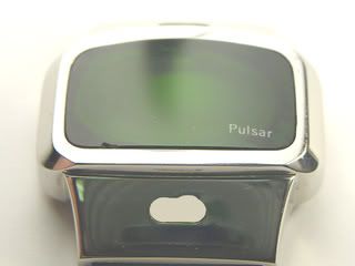

A hammer and a carpenter’s nail-set was used to punch out button after button. Hundreds of cases fell victim and it wasn’t limited to any particular model. I will say that many P4 models are what I have witnessed missing buttons but I have seen others too. As for the 3416 Green Dress, they, for the most part had the Samarium-Cobalt assembly but I have seen a few with the infamous marks from the nail-set punch. This particular one only has one button missing, probably once it was discovered it wasn't the Plantinum button assembly, they left the other button in place?

Wow, this is becoming a really interesting thread :-D (though the picture of that tortured Pulsar hurts almost physically...)
