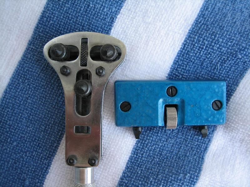

Hi Guys, I have this really nice P2 from 1973 and need to replace the batteries. My question is does this Case-Back just screw right off? Or is there some kind of trick I need to know to get it off? I can't seem to get it to start.
Here are some pics of the watch and the tools I have.
Thanks,
Todd.
http://i3.photobucket.com/albums/y100/M ... G_9201.jpg
http://i3.photobucket.com/albums/y100/M ... G_9205.jpg
http://i3.photobucket.com/albums/y100/M ... G_9209.jpg

You need this a Pulsar wrench to get this off safely. Contact Bruce Wegmann with a PM and he can help. Don't use anything else if you value your watch. There's a review of one in here
http://thedigitalwatch.com/QuickTip.htm
There was one on ebay today but for the life of me I can't find it :-?
Bruce was less expensive.

the bigger 3-point case-opener is fully sufficient to open any caseback.
if it doesn't move then apply some oil or WD40 for an hour or two and then try anew. sometimes the caseback was not closed/twisted properly so you have to try harder.
of course, Bruce's wrench is excellent for the job but you already have a multi-tool for all your watch needs.

I too have successfully used the three jaw opener shown for Pulsar watches. Using mine conventionally does not work as it does not open/expand enough to allow the engagement of the three pins, 120 degrees apart. However, if you only use two pins (1 lower, one upper) the jaws do open just enough to get two places of engagement, 180 degrees apart.....however be careful not to slip! :x
