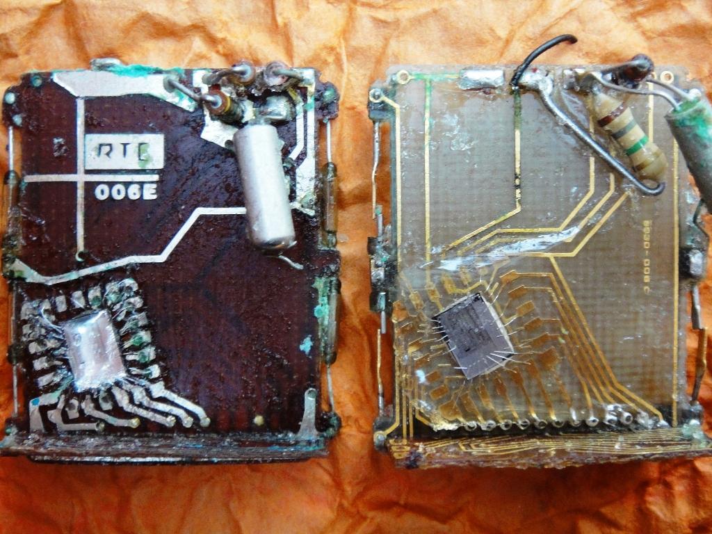

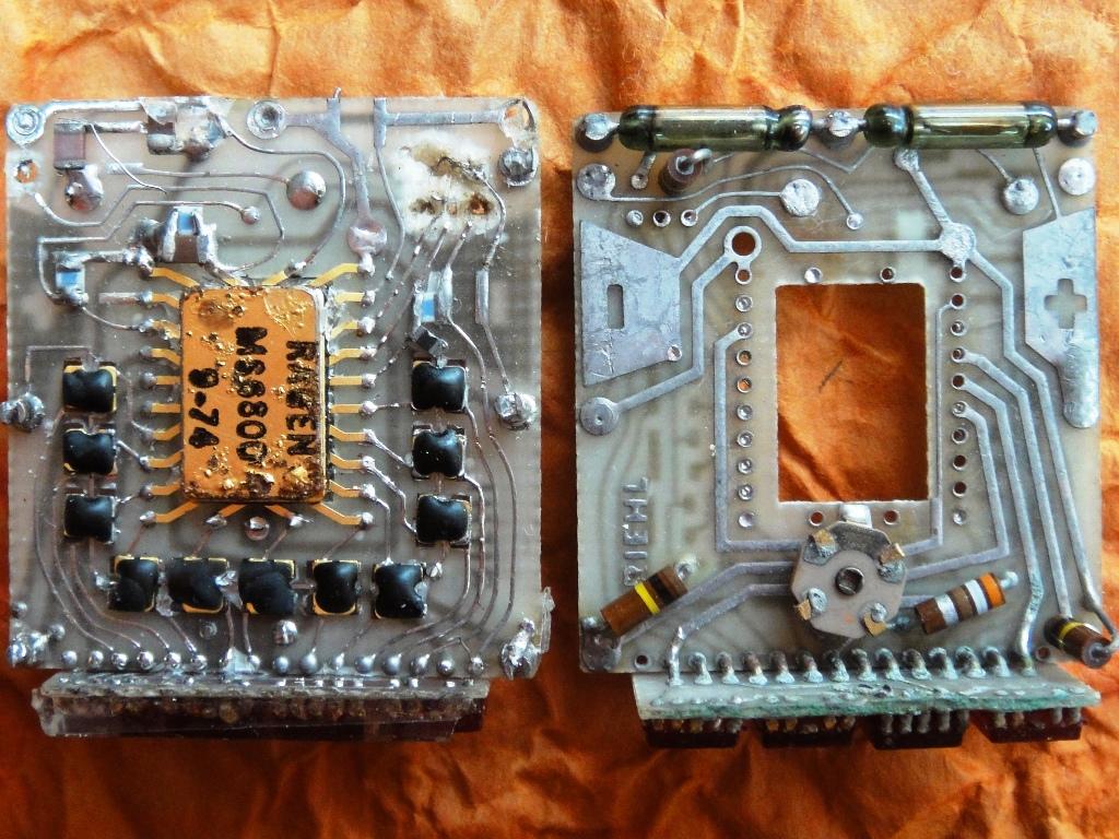

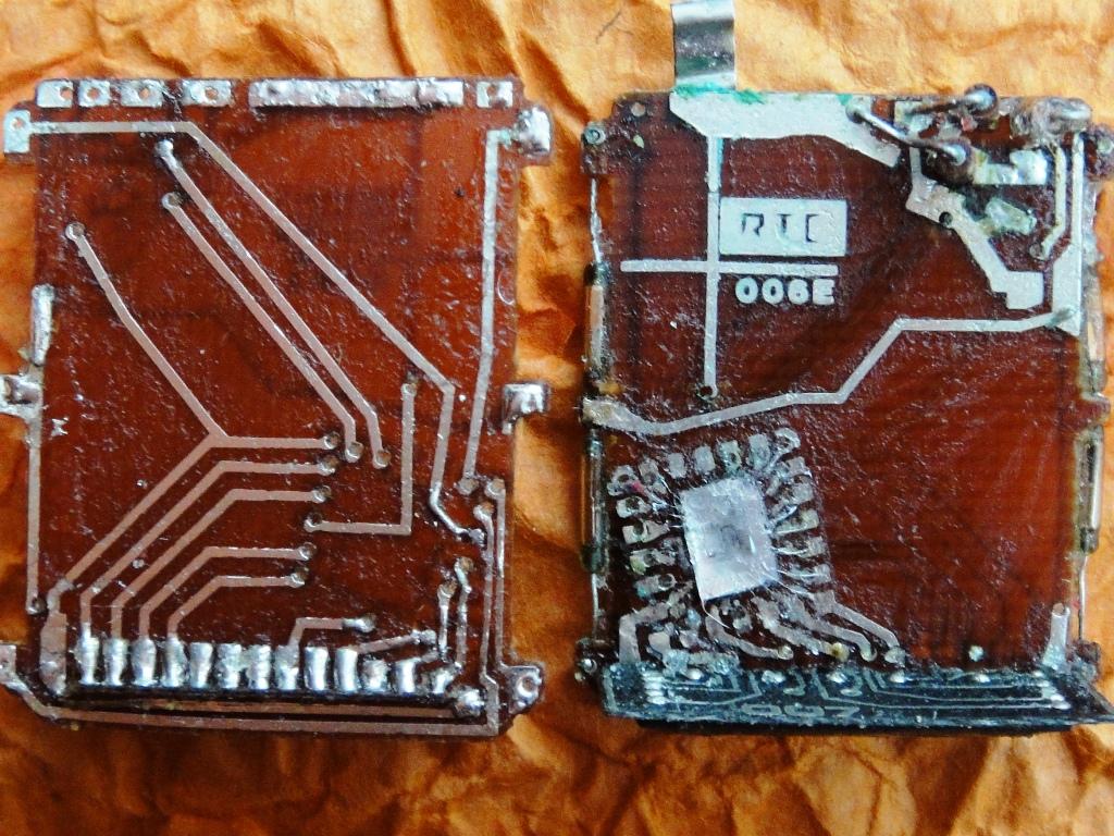

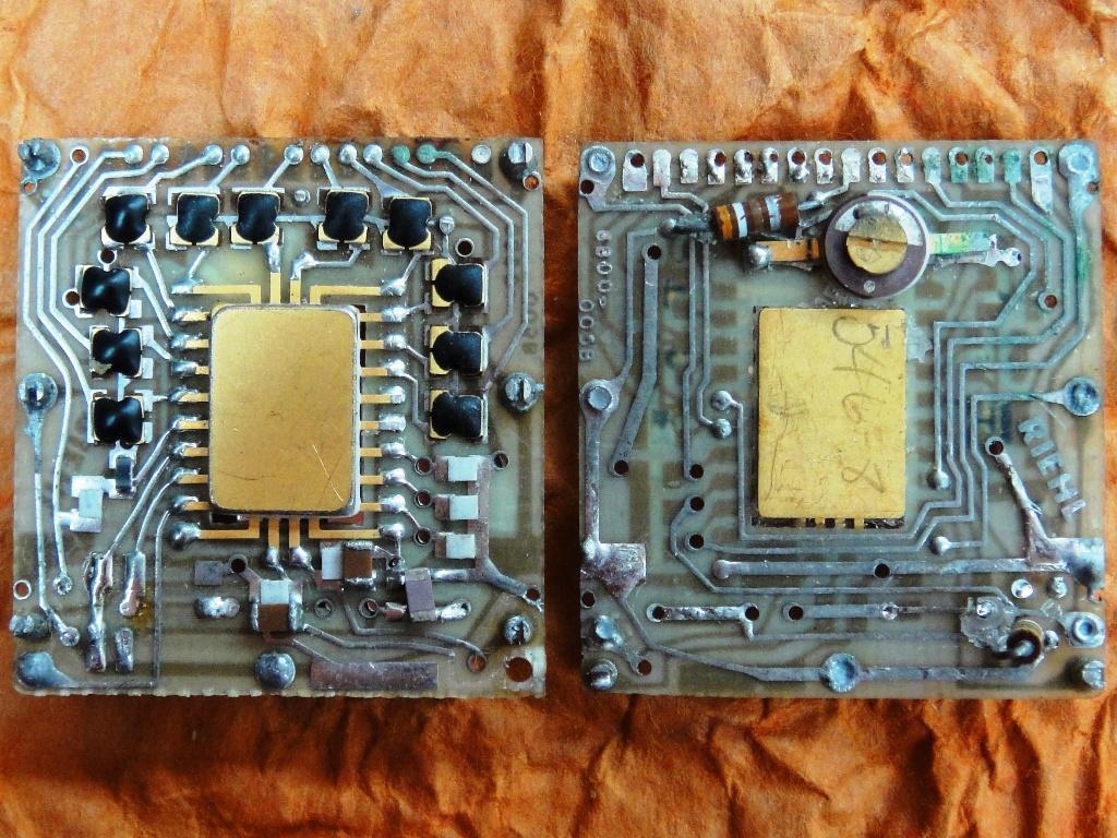

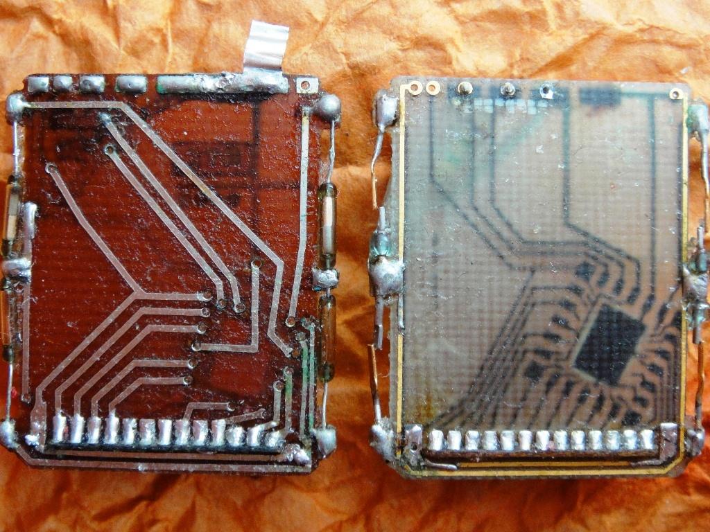

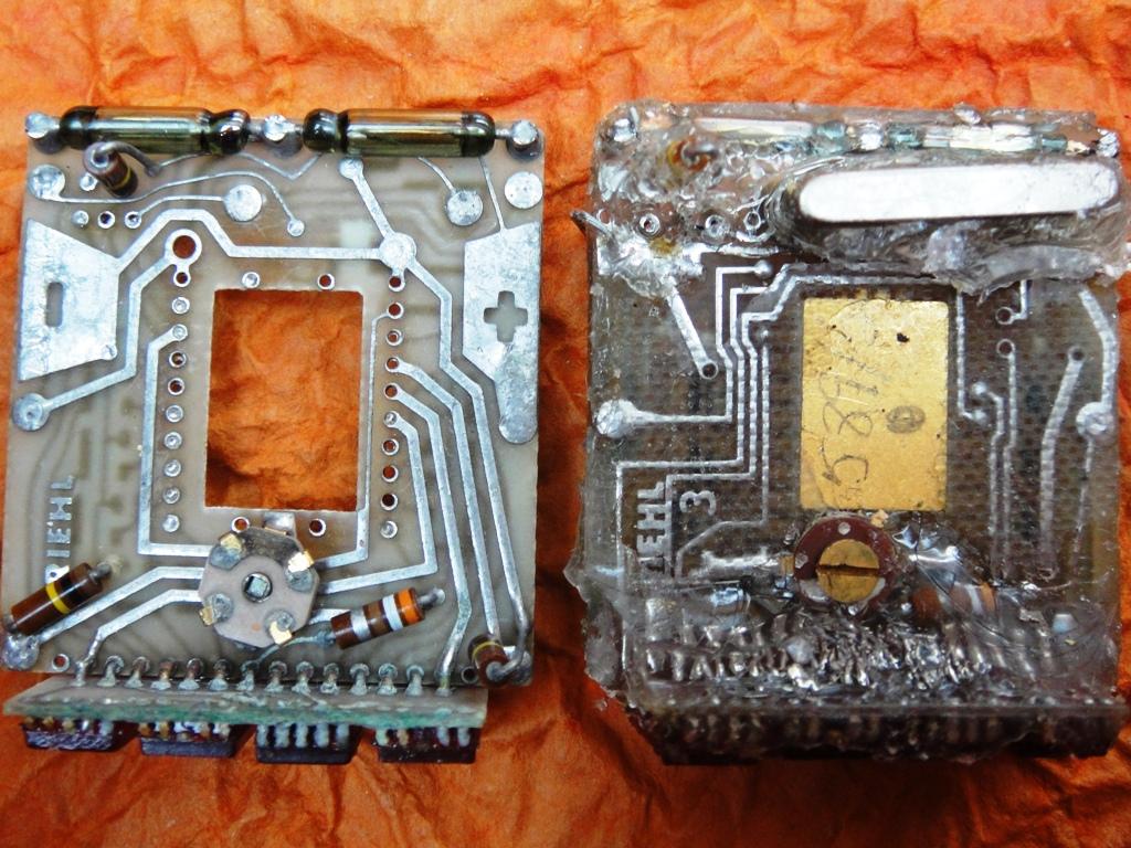

Here is a set of pictures taken last year for my website that I still haven't had the time to post in the Synchronar review.
http://www.crazywatches.pl/synchronar-2100-riehl-solar-led-1974
Hope this helps for many enthusiasts to differentiate the modules, mind that there were a few transitional/mixed modules eg Mark2 with Mark1 display, etc.
Revised after below comments from Andy, thanks! Any new input is welcome.
MkI - early and late version - top (mind the first MkI with a 1974 production chip, later than 1972 production Pulsar)
MkI - early and late version - bottom
MkIII - early and late version - top
MkIII - early and late version - bottom
MkI - early version - top and bottom
MkI - late version - top and bottom

The images above show Mk1 and MkIII modules only.
MkII modules do not have a trimmer, and have one connection from the rear reed switches "cut" on the PCB.
MkIV modules have a square chip (i.e. not rectangular).

There are many PCB variants for at least the MkIs and MkIIIs. It seems Mr. Riehl was constantly refining the PCB layouts for these models.
The MkIIs do seem a lot less common than the MkIs. It looks very similar to a Mk1, but as mentioned, has no trimmer, has one of the rear reed connections to the IC cut and bridged on the PCB and indeed only has 1 rear reed. A few of the discreet components were also integrated into the IC (the resistors between the command reeds and the IC for example). I'll load up a picture tomorrow.
Jeff Thomas and I had a discussion on this topic a while back, but unfortunately he deleted all of his posts :-( :
viewtopic.php?f=81&t=3757&p=23556&hilit=integrated#p23556
The only MkIVs I've seen have either an encapsulated IC or a square IC. The ones shown look like classic MKIIIs to me.
