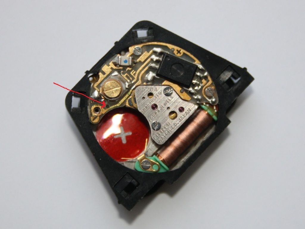

Nice watch. Be careful with battery replacement on the analogue section. The connector has a tiny 90% tit that fits in the hole i've highlighted. If you slacken the screw and attempt to slide the connector sideways the tit snaps off. Its not just a locator ,it actually connects to part of the circuit. If all else fails (i'm guessing Diginut would have pointed you here anyway) try contacting Peter Wenzig. He has spares for the Manhattan. He recently repaired a Chronosplit and a Manhattan with non working LCD for me.

Post22 Oct 2012, 20:15
Thanks for your advise!
The analog part is running okay. The dial, however was glued to the movement and came loose (do you know if the glueing part is original?)
I plan to remove the hands and re-attach the dial with double-sided sticking pads (theyre app. 1mm thick but they sponge, i have to give it a try as i prefer it over glueing)
As far as the LCD movement, it looks clean but a batery replacement didnt work. Havent tested the xtal/quartzmodule yet. Diginut has been of help, also pointing me to Peter Wenzig.
