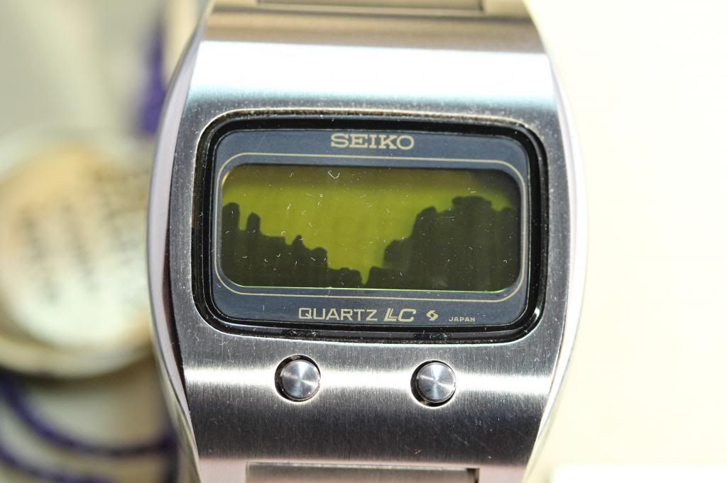

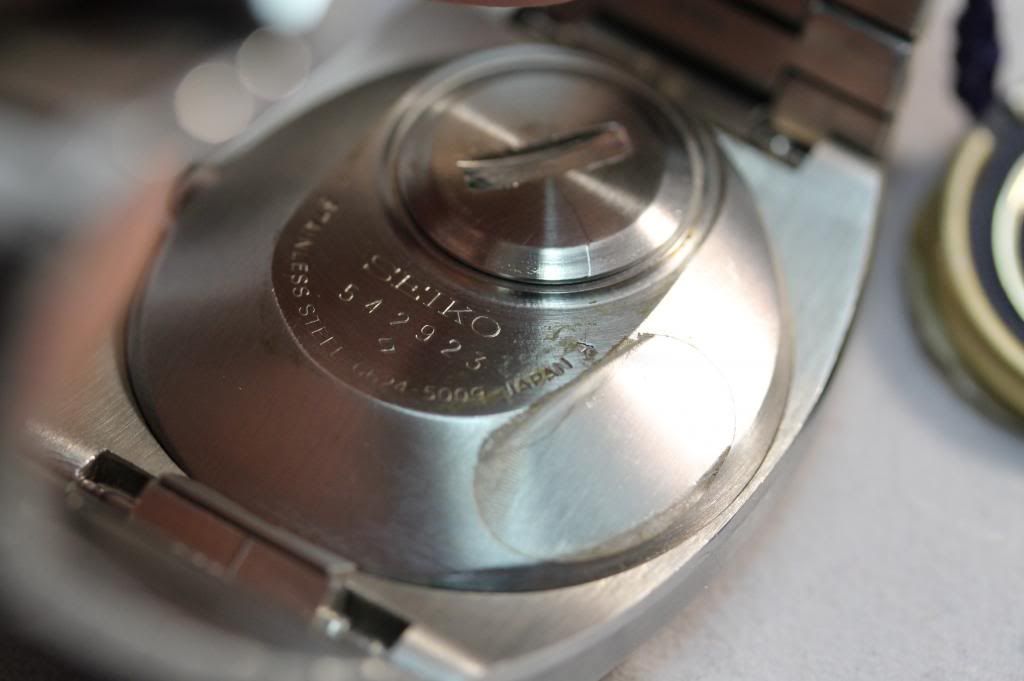

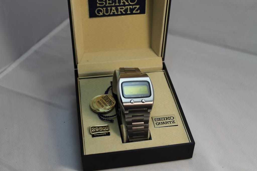

Here is a few pics of the watch in question.[img][IMG]http://i774.photobucket.com/albums/yy23/kwb6/IMG_6922_zpsc0633e0a.jpg[/img][/img]

Sorry her it is with out the link.
Re: Seiko 0624-5009
Post30 Jan 2014, 10:36
I'd say the display lost it's vacuum, we call that "Display bleeding". Only thing you can do is swapping for a new display.
